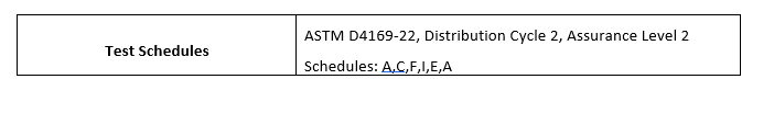

    Can anybody recommend a testing laboratory who can conduct ASTM D4169-22 testing for Schedule IV Controlled Substances?  The samples need to be stored at 2-8°C prior to and after the ASTM D4169-22 ship conditioning tests.
    Test schedules:
