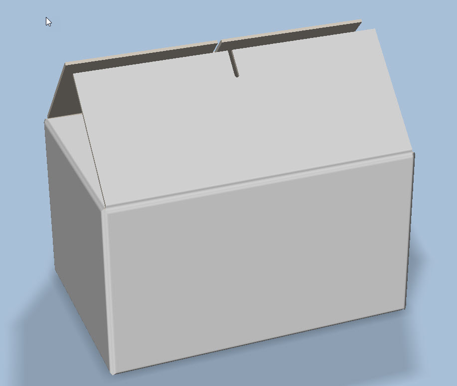

    There are a few reusable products out there that hold flaps closed temporarily, see link for one example.
    https://www.allenfield.com/product/box-flap-closure/
    You could also design custom overlap flaps that friction "lock" together and are easily reopened.
    slot lock
