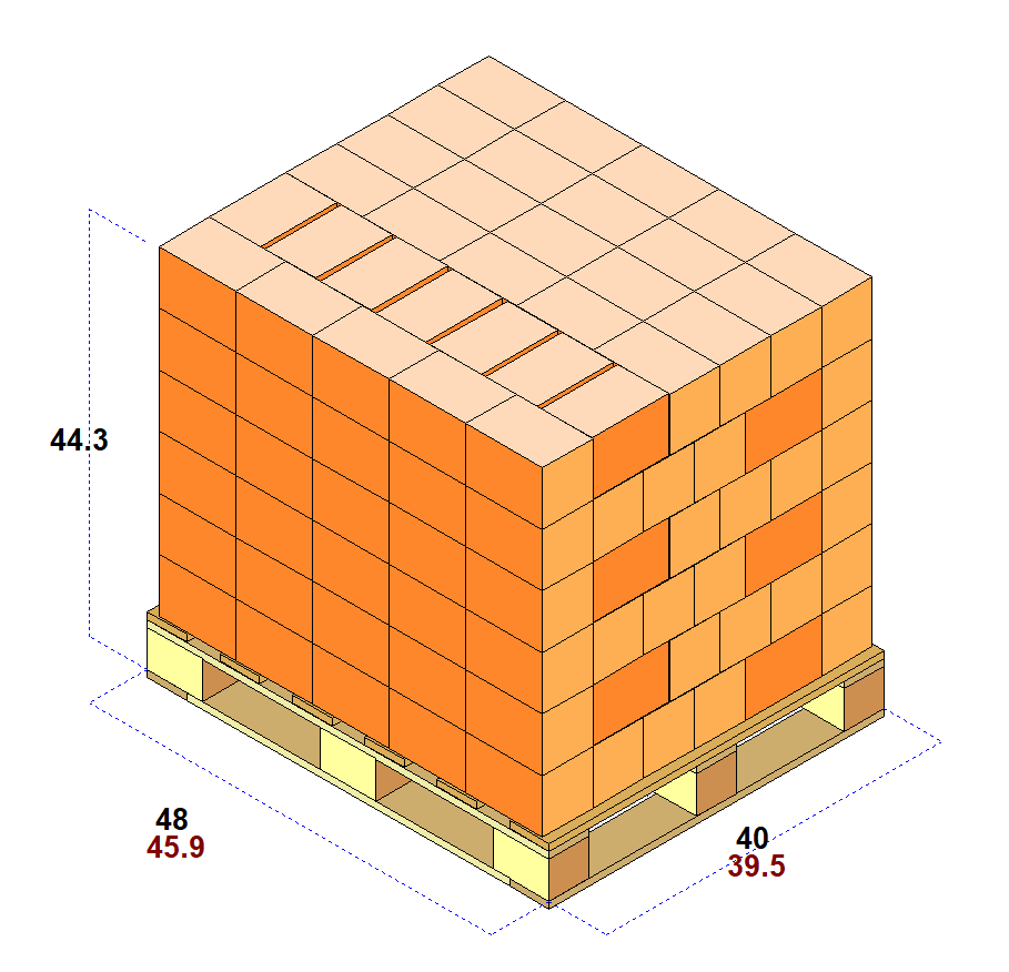

    If you can turn the case on its side so the 9.5" becomes the length, it will make the load more stable if the weight is not too heavy. Note that the corrugation is no longer vertical and you lose compression strength. You can get 32 cases/layer.
